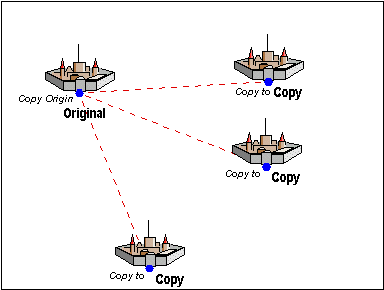

Copy enables you to create copies of any entities, with a cursor to show you what the copies will look like. It’s quicker than using the clipboard when you are copying within a drawing.
